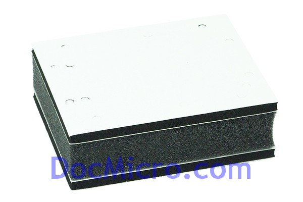

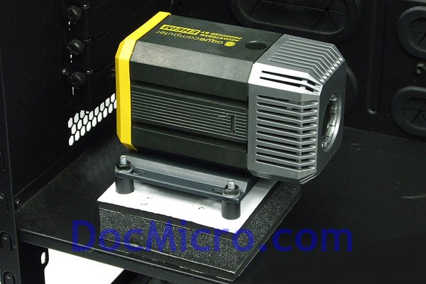

Des modèles que tu peux utiliser:
http://www.docmicro.com/pieces/Doc [...] _8214.html
http://www.docmicro.com/images/piecesV2/AC_ShoggySandwich.jpg
http://www.docmicro.com/pieces/Pho [...] _9253.html
http://www.docmicro.com/images/piecesV2/Phobya_NoiseDestructor.jpghttp://www.docmicro.com/images/piecesV2/Phobya_NoiseDestructor.1.jpg
