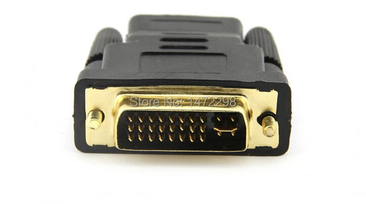

prise femelle DVI-I et DVI-D
http://blogmotion.fr/wp-content/uploads/2017/01/gtx770.jpg
prise male DVI-I // DVI-D
https://ae01.alicdn.com/kf/HTB1658yLXXXXXawXFXXq6xXFXXXw/DVI-D-Male-Dual-Link-Plug-to-HDMI-Female-Converter-Socket-Adapter-For-HDTV.jpghttps://www.staples-3p.com/s7/is/image/Staples/m001938004_sc7?$splssku$
http://blogmotion.fr/wp-content/up [...] gtx770.jpg
https://ae01.alicdn.com/kf/HTB1658y [...] r-HDTV.jpghttps://www.staples-3p.com/s7/is/im [...] ?$splssku$
